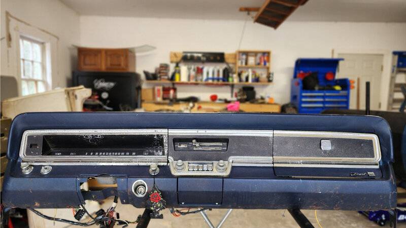

I yanked out the dash and got to work getting it refreshed. Before:

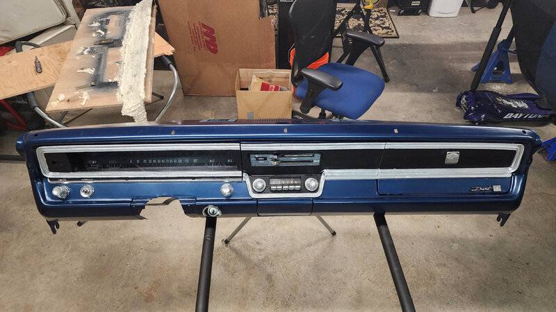

After:
Not perfect but far better than it was. Pulled the windshield and replaced the gasket/locking strips while I was at it. Windshield was leaking at the bottom corner on the passenger side.

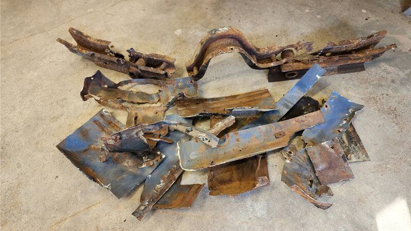

Next I cut out the rotted front floor pans and torsion bar crossmember, then got fresh metal installed. My welding is getting better. =)

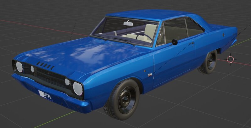

I mentioned the end game image I have for the Dart. It's mostly in my head, but kind of "on paper" as well. My inner nerd found a 3D model of a 1968 and altered it in Blender (3D modeling software) to get it as close as I can to the vision in my head. We're getting there slowly but surely.
