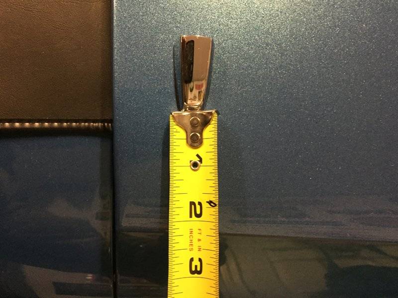

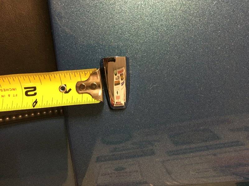

I'm adding turn signal indicators to a 68 Barracuda hood that never had them and wondering if anyone can give me the location measurements. Measuring from the hood side edge to the bezel and from the front edge of the hood to the bezel. I did get the measurements for a 69 but the lights are different than the 68 photo shows what I have........thanks
Took some fast pics at lunch.. not the best lighting, let me know if you need more.
Yes on first picture measurement 2 1/2"
From (front) side of light to edge of hood (first picture ) 1 3/16"
From (back) side of light to edge of hood ( second pic) 1 1/6"
The reason for different measurements if because the light is tapered towards the front of light.

Got it Darren, thank you
