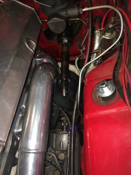

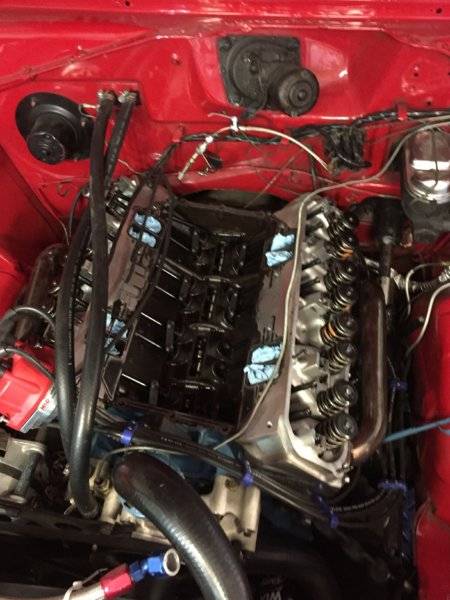

look for some ideas on what happened to my column length. I went to put the column back in today and it’s a good 2”-3” longer at the u-joint. Are these solid steel shaft or does the center slide in. If you look at the picture, you can see where the bearing sat. Can I tap this is with a mallet? The pic with out the intake is the before, the other is where I am at now. Interested in the distance from the outer tube to the end of the solid bar / shaft. Thanks Andrew
Question, did you change steering boxes? Do you have the steering wheel on? You can loosen the bolts on the inside from the firewall I think 5, and the 3 that hold the column to the dash. Only loosen and then see if you can push the column to mate with the the box.
may have beoken the plastic pin trying to yanm it out while removong
That maybe true, I forgot about it. Good one mbaird, Have you just pulled on the shaft to see if it will extend?
Same steering box. Just wondering if I can tap on the end of it to collapse it or if it is a solid bar / rod from the steering wheel to the steering box. Thanks
It is a collapsible two piece rod. Push on it to see if it will shorten. There is a couple of plastic sliders in the rod assembly.
Man! Thanks so much. It kicked my butt for the last 3 hours. Thought it was a solid bar. Beer time! Andrew
