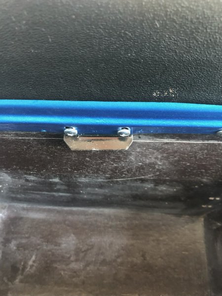

Does anyone have a photo of the catch that fastens to the top of the glove box and hangs down? Can't seem to find one for sale. If I knew what it looks like, I can probably make one.

I fabricated my own today using 18ga metal & welded two nuts on the topside. See photo. Used thicker bumper stops which helps the door pop open when button is pushed. Works like a charm. Thanks for the feedback. Case closed.
