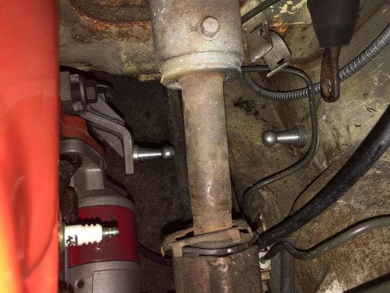

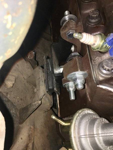

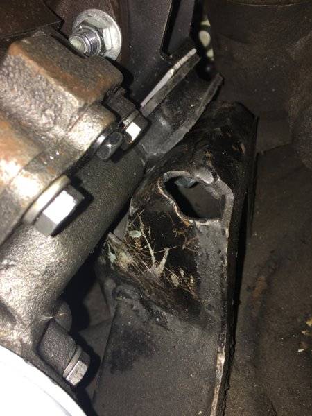

Hey guys-

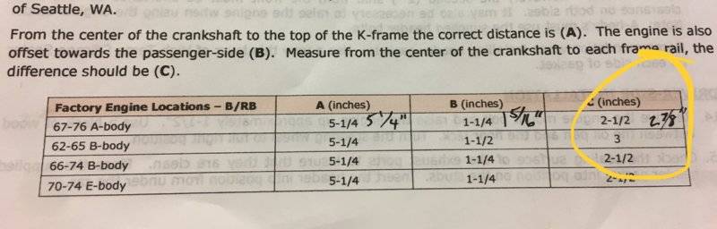

I’ve finally been able install my rebuilt 383 and A833 into my 318 engine K member bay. Before plowing forward, I’m just looking for some feedback on how things look as far as engine stance/offset in the mounts, Z-bar (from TTI), ball studs, TTI measurements, oil pump housing, etc...

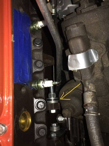

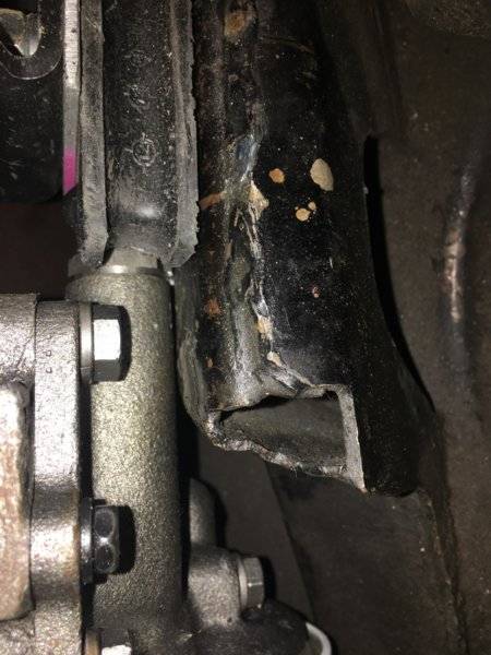

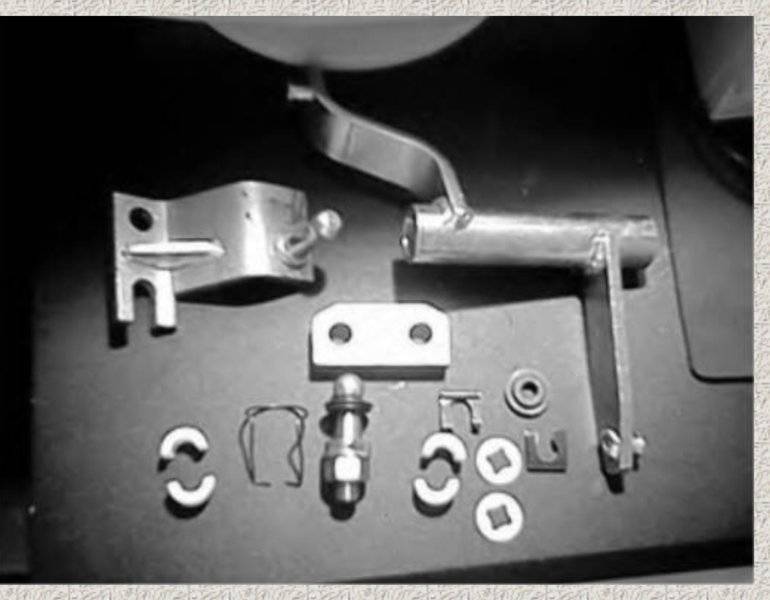

I used the Trans-dapt conversion mounts, and notched my K member and one of the mounts for the oil pump. I’m planning on TTI headers. I do have the #2468372 bell housing and appropriate Z-bar and ball stud kit for my application. Ball studs line up super close height-wise from floor, but you can see they are just a tad off as far as approach angle.
With the shim under the driver’s side mount the engine is perfectly level from side to side, but it appears that it could be about a 1/4” more than the standard offset to the left of center. The measurements (based on the center of the crankshaft) I’ve taken are pretty darn close to what TTI supplies for my application. As you can see, I’m about 1/8” away from the power steering housing, so I wouldn’t have room to come back toward the drivers side with the engine.
I’ll just post my pics and see what y’all think of my current configuration...

Looks like u at least need to raise it up some ----
I can't find any pictures of mine but it looks like the rubber insulators are reversed and the whole engine is too far back. Does the trans mount line up?
I've thought about this many times as well.... Mounts are correct, according to the instructions for "V8 to Big Block Conversion Kit"... Schumacher's conversion mounts look exactly like Trans-Dapt's, and Trans-Dapt even supplies the same instructions that Schumacher has on their website.

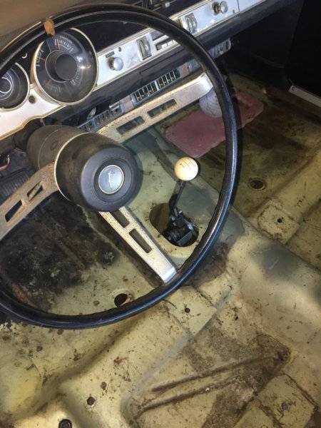

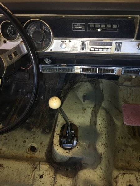

Good question about the trans mounts.... the transmission mount holes line up perfectly with cross-member, etc...(as well as all of the shift linkage and the Hurst shifter coming up through the floor) and the Clutch ball studs are super close, so I don't see how anything can be reversed. But I'm open... to any and all thoughts. Thanks for the feedback.
