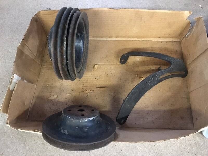

In need of factory 1970 340 pulleys. I need the crank, and fan/water pump pulleys. This is a factory air car, but no power steering or brakes. I could also use the alternator brackets and A/C compressor and brackets.
Sooo that's a 3 groove crank pulley? Got a picture?
I have this 37691-41 7"/7.75"x3" 3 groove
A/C alternator bracket LA
Flat triangle upper bracket LA
Curved lower alt bracket LA
Here is what I have, not exactly sure of what you need. If I can help, let me know.

340 with air takes a special bracket with idler pulley as seen in the first picture when it has manual steering. It was left on tis motor when power steering was added . It is needed to run the water pump without power steering. Very hard item to find. I sold one to a member on this site. I have two left and they are not for sale. Good luck finding this idler Very Very rare item.
