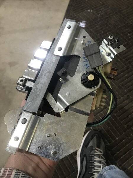

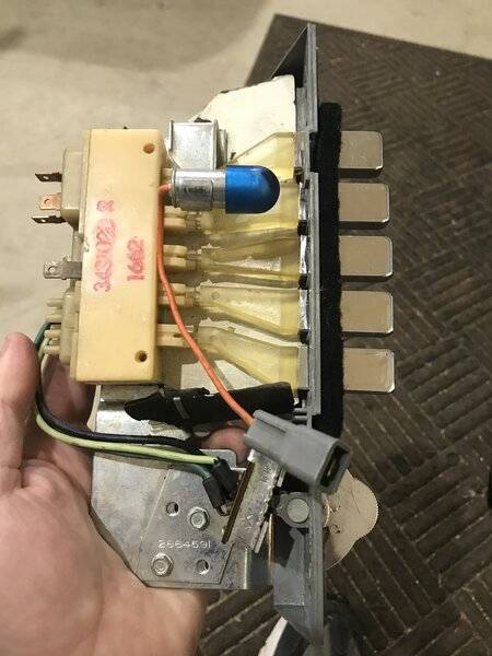

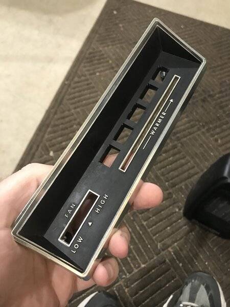

I have some air conditioning/heat/blower controls....what years do these all fit? This is 1970-71 Duster (had the plastic trim bezel but removed to clean) will they work in the 67-69 Barracuda and Valiants also? How about 70-71 Dodge Dart, with or without the Rallye dash? I know the trim bezel is different but trying to verify what the controls all fit, Thanks!
The controller is the same from 67 to 72. There were slight variations in the vacuum/electric block over the years. I'm not sure if 66 is the same. Early a-bodies had larger buttons.
I must add that is a nice example. Many of them have fonts worn away and button stems so yellowed that light cannot transmit.
Thanks! BTW, it’s new old stock :)
I put a 71 dart ac in my 69 no ac cuda. Fit fine. The mounting bracket on the assembly is different in 67, but can be adapted. I have a 67 dash bezel in mine.
