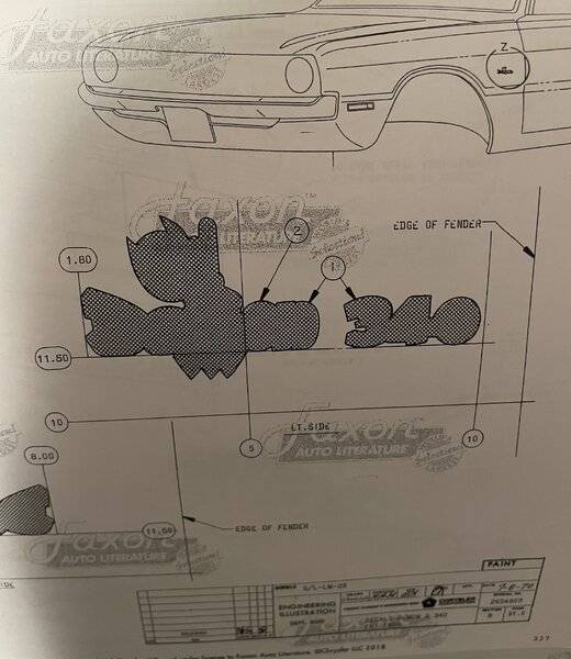

Almost there.........Does anyone have detailed measurements as to where the "Demon 340" decals get placed on the front fenders?

Attached
Thanks for posting. I still can't figure it out with the reference #s on the pics LOL. Maybe I'll just leave them off :(
Go to the link I posted. In there you'll see some pictures of the demon logos on the orange car.
