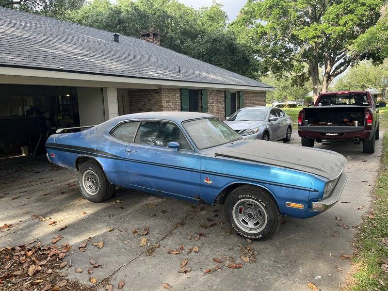

I know this has been asked a million times but im not finding a straight answer. I have vision wheels 15x7 4.25”bs on fron and 15x8 on rear. I got the front tires free and bought the rears myself but im having clearance issues on the front fenders and the rears are way too tight for comfort. I honestly want a tire package that would be great for autocross with plenty of clearance. Ill be changing the rear leafs out for hotchkiss most likely. I have QA1 parts everywhere else. Thanks everyone.
