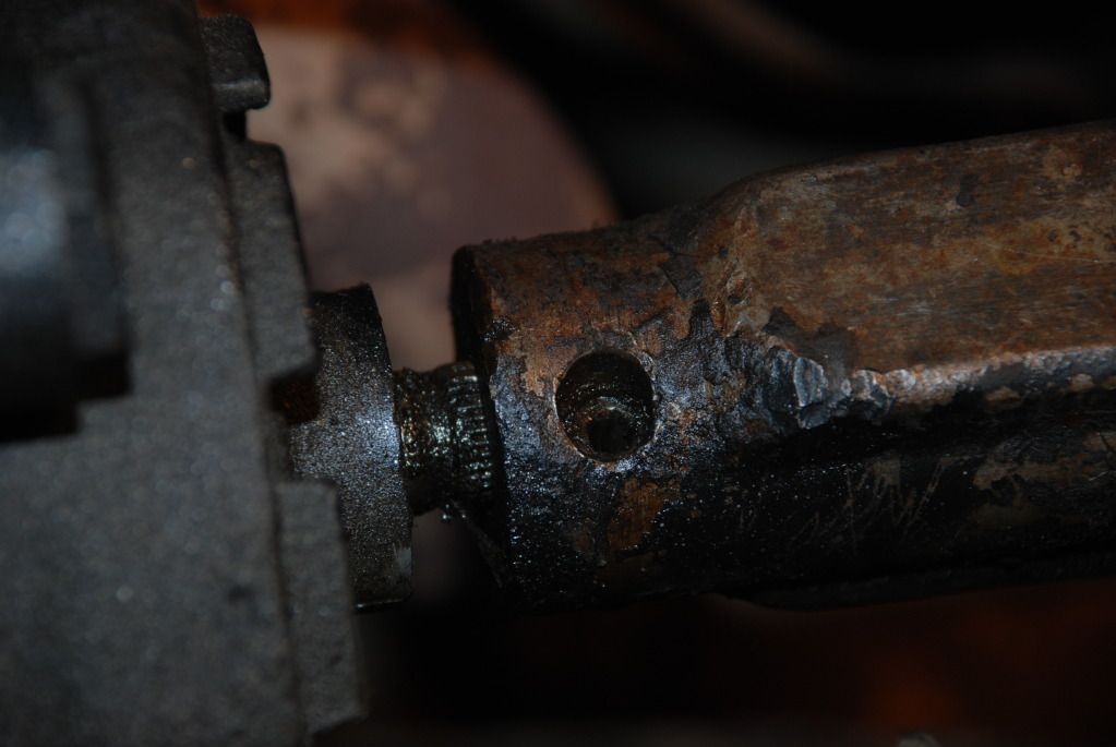

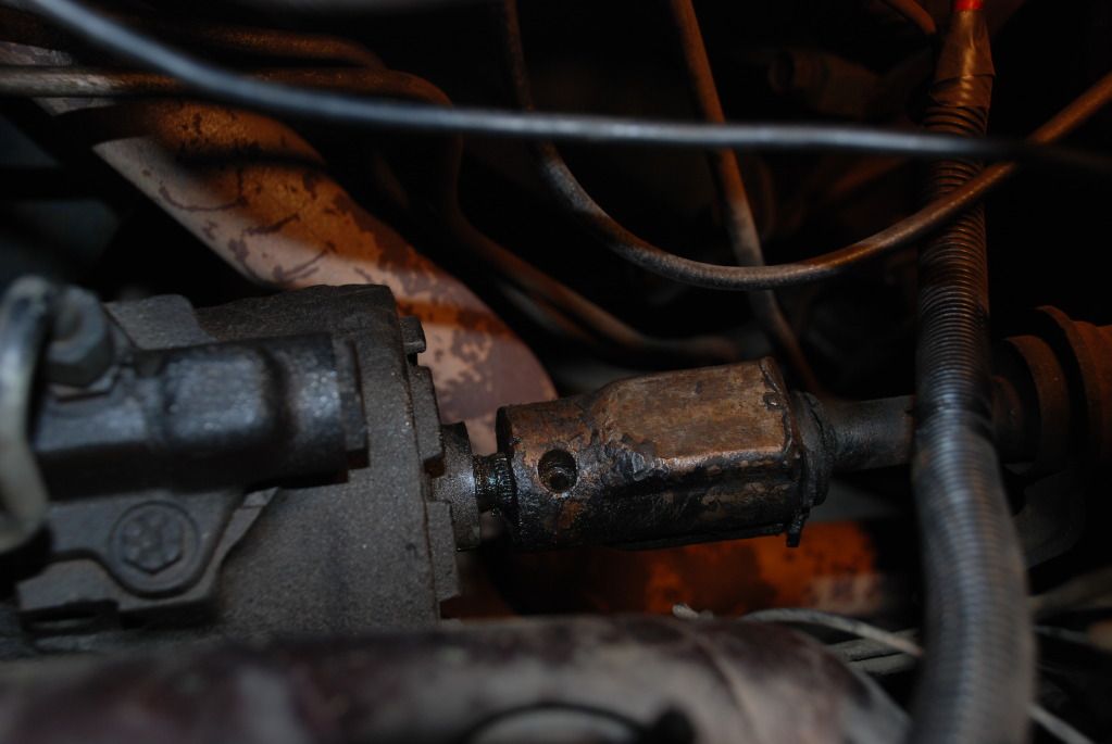

Well I have let this go long enough and have asked around town at the auto shops to see what was supposed to be in this hole...

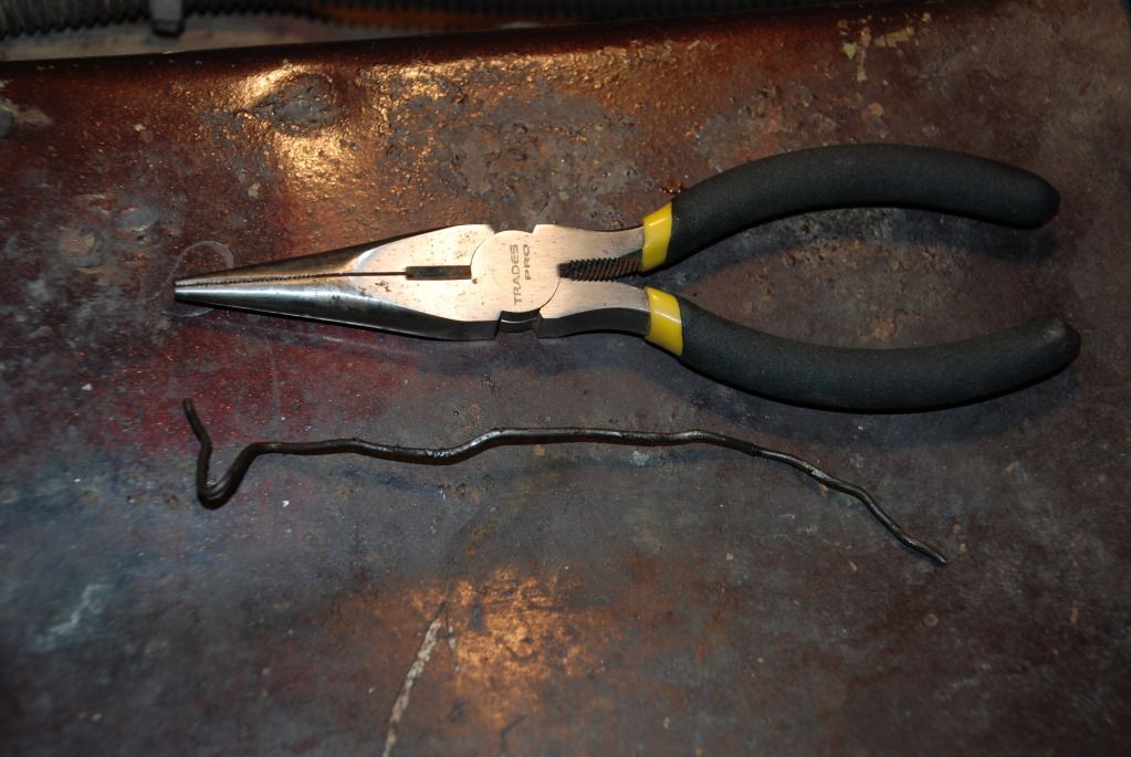

What was in there was this wire.....
So.. as you can see I'm 99.9999999% sure that is not the part for that :p Is there supposed to be a pin in there?

The steering coupler is supposed to have a pin in it. The lack of the pin, and the blue steering column make me think that the power steering may have been added later, and the column picked up to match the steering (manual steering shafts are longer than power steering shafts). But decoding the fender tag should tell you.
