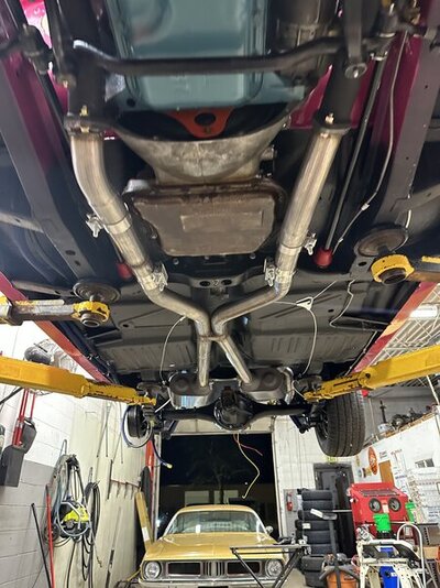

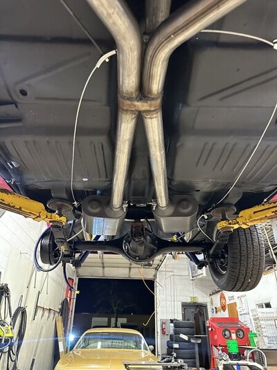

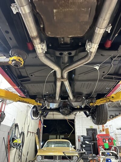

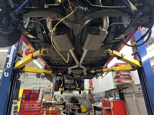

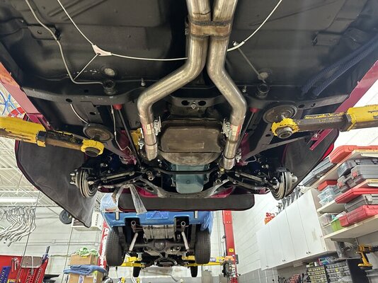

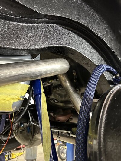

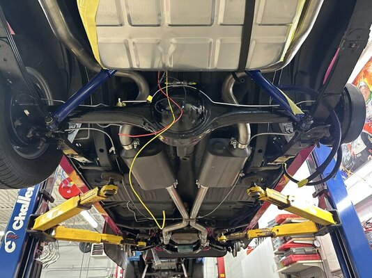

Next was the 8 3/4 , as luck would have it , found a bent axle flange , and defective drums that wound lock up when you tightened down the rim

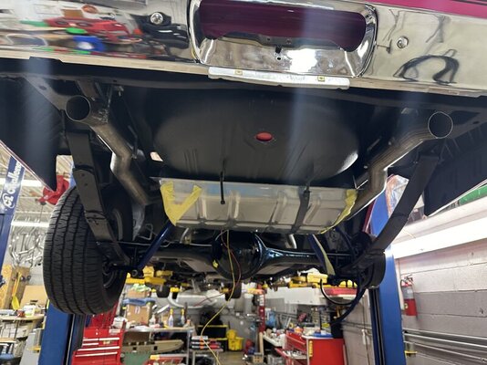

Running a Holley sniper to feed the 383 , installed the efi tank from tanks inc

Wow.....what a transformation! Looks really nice. Is that the Moulin Rouge from newer Challengers? It looks good on that car. If you're doing front disc brakes, double check your proportioning valve. It looks like one from a drum brake car. Keep up the good work, and thanks for sharing!

Thank you .,the code is an early paint code, Icm gonna change the prop valve out to a disk set up ..
