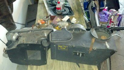

left heater box outlet..hose..left defroster vent.
right heater box outlet..hose..right defroster vent.

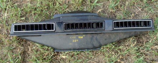

Panel vents are mated to the front of the heater/AC box....no ducting except the 3 vent diffuser.
