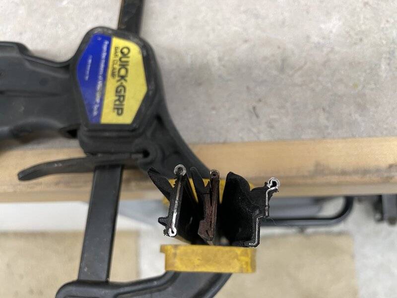

My 73 Duster has been completed for a year and I have been using this covid time to work out some of the little issues I had with the build. I'm currently working on the door windows fitment and found an issue with the new cat whiskers I installed in the car. Attached is a picture of the original outside drivers door sweep next to a new replacement premium Cat whiskers. The new sweep forces the glass inward towards the passenger compartment and makes the door very hard too close. Does anyone have experience with this that could help out?

After getting no responses, I've been looking to find something and found these exact replacements at Metro Molded parts. Wow.... these duplicate my original 73 fuzzies exactly and will fix my door adjustment issues I'm having. They were not listed on the web page but I was able to message Mike Hinshaw and he found them for me. Here are a couple of pictures for everyones reference. The first picture is the end view of three fuzzies. The first one on the left is the new metro molded one I just purchased. The middle is my original and the one to the far right is a premium cat whiskers that doesn't work. It pushes the window into the car about a 1/4 to 1/2 inch. The second picture is the box end with the part number.
