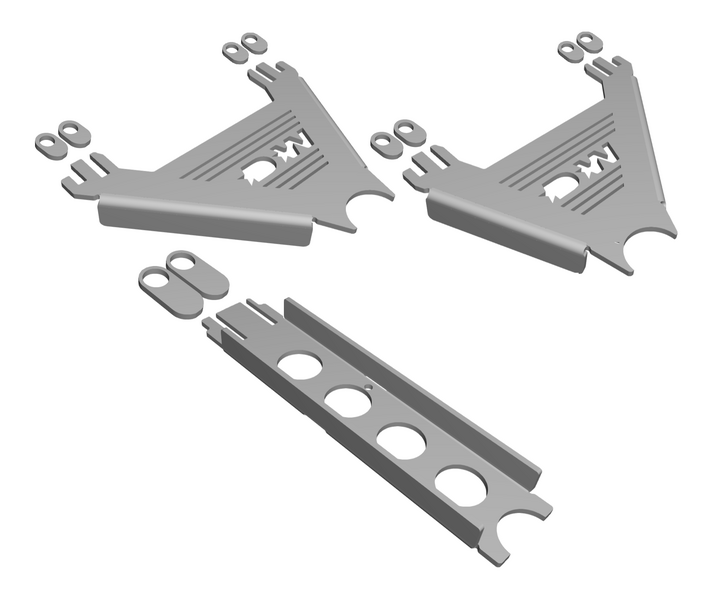

Got an update on my side project. The jig was completed, and I have a rough draft of control arms for Wilwood MII pro spindles and brake kit. Im still gathering things to bring about a final part in my hands, and I got a couple of Cummins powered trucks to thrash on with these for strength testing. The only part I dont have a solid answer for yet are the coil overs, I have 750 lb springs on QA1 coil overs for GM vehicles in mind, and I think the placement of the lower mount on the lower control arm is what I need to dial in, and possibly make adjustable depending on the front axle weight of each truck. I may be able to figure in a rack n pinion setup as well, and if I do, It will be on youtube, and here.

I updated the design and will have 3 basic packages for this setup if testing goes well: A stand alone upper control arm set for guys (and gals) running van LCAs, and an upper and lower control arm package for MII spindles, and for OEM D100/D150 spindles, both will include rearward facing adjustable strut rods. Next week I will have the Dodge spindle option Control Arm Package in hand, because they are currently cutting through tried and true SendCutSend. This set is going to be tested on a mid 70s Club Cab D100 with a Cummins swap. If these hold up well to that thrashing, I will offer them finally.

Boy do I have progress updates that are months behind on here. Ive been a bit more active on RCC as far as updates go and Ive been doing nearly everything I set my sights on. Im at the final stages of my control arms, something I need to finish and install on my chassis so I can move it around and continue the work on my truck. Ill just post some pictures of where I am as of the last 2 weeks. The control arm design had been updated 2 times since last you seen here. This current set is the most refined so far. I should have the Viking coil overs Monday or Wednesday, they were ordered a week ago. The Wilwood M2 pro spindle and brake package is 100% assembled and ready to bolt in as soon as the control arms are installed.
