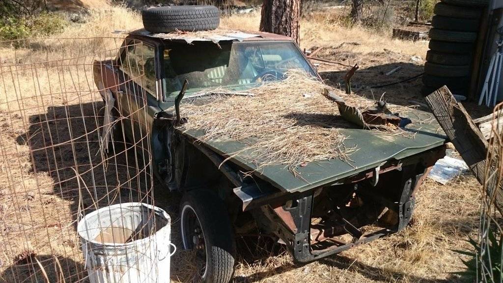

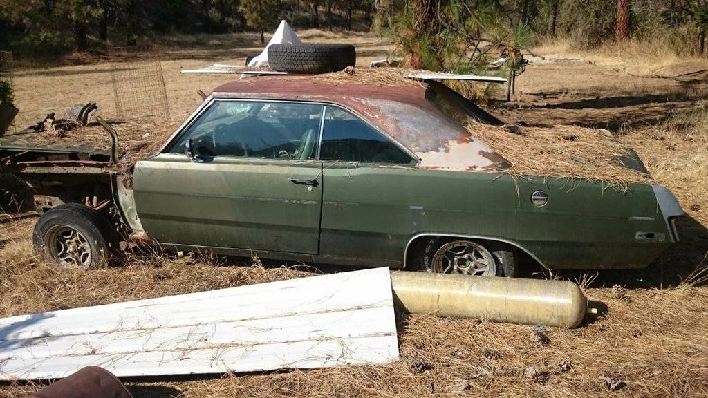

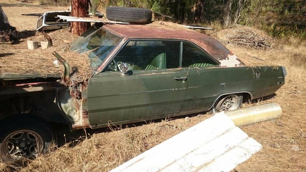

We're slowly moving along and this will likely be a year long project - Please keep in mind these are photos of the car in it's most primitive, located where we found it for sale. This isn't what I've done to the vehicle only the condition it was found.
