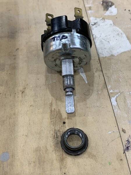

In the photo, you see the switch and the nut that holds it in place. It seems like there should be another piece between the switch and the nut, but it’s been so long since I’ve taken this apart I can’t remember.
No, the shank on the switch should fit tight in the dash "keyhole" and bottom out against the back of the cluster frame. The nut just holds it in place.
