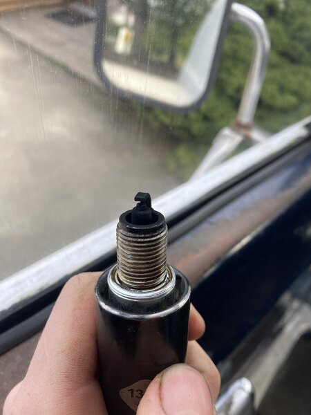

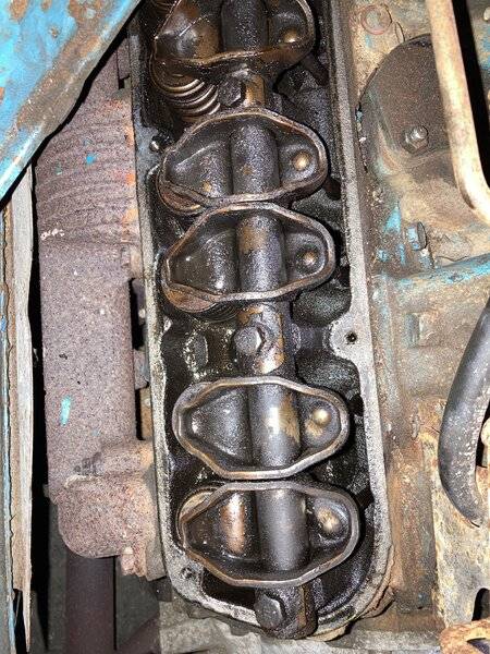

so i read all the replies and yeah in hindsight should’ve done a compression test, yes i’m a young’n yes a 77 dodge van is great first vehicle maybe one with a better motor but besides the point, i’ve taken the valve covers off and on both sides done a very basic inspection of everything besides looking like it’s got 40 years of wear and debris it all looked good, all push rods and rocker arms we’re moving freely except three back two on the driver side and first one on passenger side, i was able to get to push rods to spin so i don’t think there bent but nonetheless, i’ve also done distributer cap roulette and cylinders 6,5,7 i believe to be misfiring because when i pull those ignition wires from the distributer cap nothing changes, the carb has also been redone since i’ve got the van(by a certified mechanic) but i do agree something is up with my carb and something me be happening to my fuel delivery system, and for the person who mentioned my hose setup i completely agree i’ve been scouring the internet forums and it just don’t look right. and for the anyone wondering yes my wires are usually better than that i had double checked my firing order so they were still messy. i’ve also got a photo of the spot from my exhaust i don’t know if that’s just carbon build up or super rich fuel with possibly oil in it, and again i appreciate all the input and information
okay, first, good on you for recognizing a problem and jumping it and trying to fix it.
second, those plugs look horrible.
which brings us to this:
yeah, that's not bueno.
the back two on the driver's side? that's 5 & 7, the two that you mention when you pull the wires nothing changes. so, i'm *guessing* that you've got stuck valves or collapsed lifters.
but yeah, all the rockers have to, ya'know, rock.
