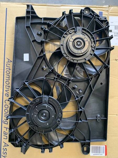

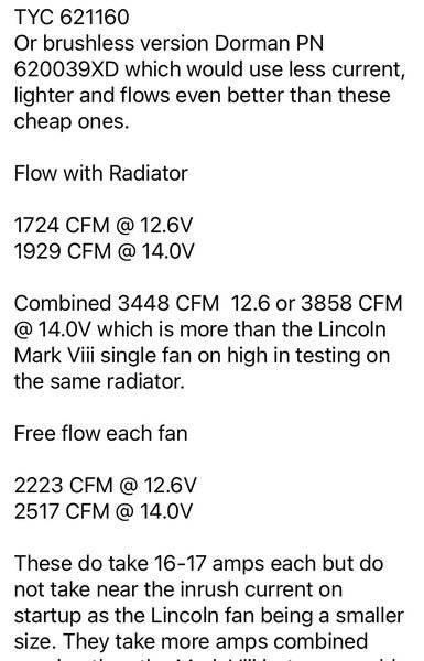

Bought one of these cheap off of Amazon after seeing good reviews about it on line. It won’t clear my BMW radiator but I’m considering buying a different rad just to fit these fans. Combined CFM is about 3450.
Sharing pics and dimensions here if other folks want to consider using it.
Around the perimeter without the mounting ears the shroud is 24”x18.75”. From outside of fan to outside of fan it’s 25” wide. About 3.5” deep at the fan motors.
