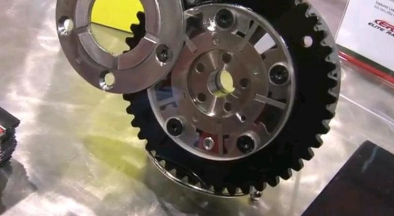

Some possible specs on the stock Eagle cams
info from: http://www.challengertalk.com/forums/f18/comp-cams-new-5-7-hemi-xfi-cams-40667/index6.html

Excellent Research Cevidicus,
The only part I don't like is how Comp Cams is applying for a patent for their phase limiters. This could restrict the availability of parts.
Otherwise this is good news.
Regards,
Joe Dokes
Thanks. I've been researching this engine for nearly 2 years now. Been down many dead end roads and faced many disappointments.
Im tickled that somebody finally came out with the phaser limiters.
But, may not matter in my circumstances.
It's looking more and more like MegaSquirt will be the way to go for me. If not Ill lock out the phaser and run a carb with a FAST XIM ignition.
