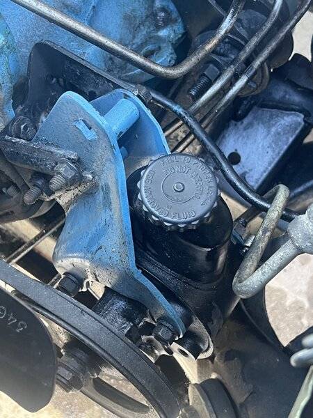

My new project Mopar is a 62 D100 pickup.
It takes the "Hulk" to turn this wheel, though....and almost none of these came with power steering... I've looked hard to find one, with no luck. I bought a kit online and started a conversion, so when I die....one of my kids will want this truck.
After a lot of trouble getting the knuckle in, I'm now at the pump installation. I bought the 2,000psi pump, as required, but the mounting bracket is not provided. It's a 225ci engine and the Federal/TRW pump bracket doesn't fit the pump.
Attached is a pic of the pump and if someone has a bracket, knows how to install it, or knows what bracket that I should buy...Your help would be appreciated
They also had a small neck power steering reservoir pump (67
and earlier years. If the original poster could show the opening
hole area, and also the backside of the pump with pics, would
be very helpful in identifying the pump. I am assuming from
what I can see, it is a TRW pump.
The pump is a Saginaw style.
There are no "mounting holes" on the left side of this pump, they are on the front & back faces
