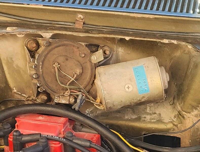

does anyone have a diagram for the 3 speed wiper motor? i went to use them the other day and found out they were not functioning, i tested and i am getting power and ground to them so i was going to run through and check to make sure something didnt get crossed because i noticed the insulation is coming off, i didnt know if there was a way to test it or if it burned out, the red wire had broken and i soldered it back together but then i started seeing smoke from it, its on my 72 dart

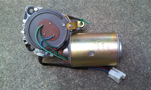

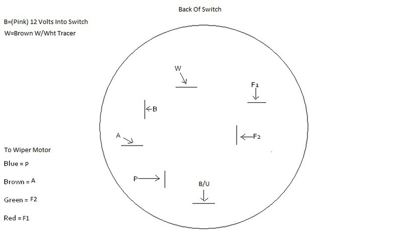

So this is for the motor, however the wires from the switch should essentially go to the motor except for the power in.
MOPAR 3 SPEED WIPER MOTOR BENCH TEST
  • High Speed
  • Connect jumper wire from motor case to battery ground
  • Connect second jumper wire from battery positive to BROWN lead
Motor should run on high speed continuously
  • Low Speed
  • Connect jumper wire from GREEN wire to batter ground
  • Join the BROWN and RED wires together and connect to battery positive
Motor should run on slow speed continuously
  • Park
  • Connect jumper wire from GREEN to BROWN
  • Connect jumper wire from RED to ground
  • Connect jumper from BLUE to positive

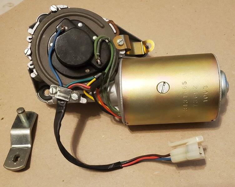

IIRC the FSM shows the wiring for the 3 speed motor by default.
1 extra wire over the 2 speed.
If the insulation on the wires is crumbling off ( seems like it in your photo) I would look at that as problem #1

I assume this is for a 2-speed wiper test. Dana67Dart says 1 more wire for 3-speed, can we find the test for the 3-speed?

Just got my newly remanufactured motor in and got it swapped out, I thought I was going to have to drop the air vents/ heater box but I was able to take the glove box liner out and reach in far enough to unbolt the wipee transmission, now everything works park 1, 2 and 3 function normally I figured it was probably the motor itself since the wiring insulation wore away and became bare wires that arced and burned out the motor since it was smoking and very hot
