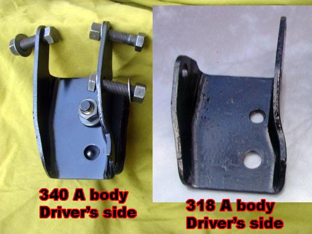

I dove into a little bit on the motor mount threads and was confused on what I need to get, but I know I'll need to do something at least on one side for it to work.
What else do I need to get my hands on that I am forgetting?
Passenger mounts are the same, but the drivers mount is different. Grabbed this pic from the net........Probably one of our members posted it.
