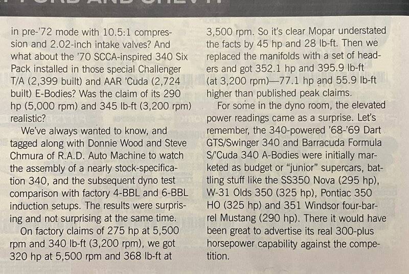

While looking through this, I ran across this article:
The text of the article stated that with this test engine, they claimed to use the stock cam, stock compression ratio but roller tipped rocker arms…
They show 320 HP compared to the factory rating of 275 on the 4 barrel.
Really? The 68-70 440 Magnum had 100 cubes on the 340 and has been found to actually register between 335-350 Hp despite the 375 HP rating.
Taking it further, they swapped on a 6 barrel induction and scored 356 HP.
Again, really ??
I ask this because it seems exaggerated to me.
I’m building a 1990 360 with compression in the mid 9s, #308 heads, 1.6 ratio rockers and a Hughes roller cam with .544 lift, approximately .100” more lift than a 340 cam. I’ll be running a Holley 750 and 1 5/8” headers but I can’t imagine that I’d be at 376 HP with my combination. Their claims seem too high.
I've always thought it was funny that the 370HP 350 Chevy was built about the same as the early 340s. Only 10 more cubes and 370HP. It did have a solid lifter cam and .5 point more compression, but that's not all that different.
Problem is so far as I've seen anyone whose dyno a stock 340 there never a 100% stock.
To me it's not hard to believe that a 100% stock 340 would dyno more than it's 275 hp rating. especially in dyno trim, usually means, no accessories, headers, dyno carb max tune probably gonna be mid 300's. I could see the 275 hp actually being it's net rating or pretty close to it.
