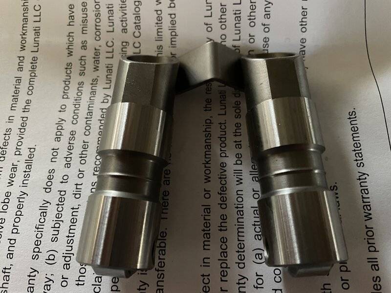

Lunati does not manufacture lifters they source them from an aftermarket supplier. True a few are made in the us. The rollers in pic's look like Morel lifters manufactured by John Callies which are normally quality pieces. On the other side of the coin they could also be a chinese knock off's.
