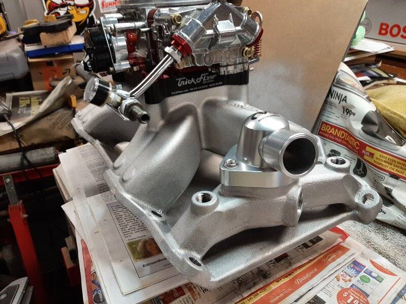

All great options. Honorable mention goes to an Edelbrock AVS2 800 manual choke. Go through it and check the OOB float heights and air door tension. Install the dual feed line kit with a pressure gauge and regulate it to 6-1/2 pounds if need be. Jetting out of the box should be very close to spot on.
Agree with your points on this carb, I am very happy with mine. On the dual feed kit for this specific application, I was told by Edelbrock tech it was for asthetics and not a benefit to performance. I cannot confirm nor deny as I do not have one, nor experience with one. I am considering trying one.
