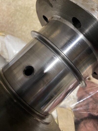

Anybody hear of a small block not having the crank knurled at the rear main seal?
I have a virgin crate motor ( P4876908 ) I have had for over 15 years and I decided to tear down and inspect before assembly and install.
Mic shows the crank is standard size ( not turned ).Upon removing the main caps I noticed the crank has no knurling at the seal. I have never seen a small block without knurling, This seems to me It would leak without the knurling and not forcing the oil back into the crankcase.
Any thoughts?
That is a 5.9 Magnum deal. They leak less. It is a good thing. Knurling was originally for rope seals.
Some say aftermarket cranks have excessive knurling and leak more.

By the way you're better off without the knurl marks all they do is make that Rubber seal leak.

I have had rusted BB crankshafts welded and machined on the rear main seal surface. Zero leaks with a fel-pro stock rear main seal. The machine shop said it would be just fine, and it is.
