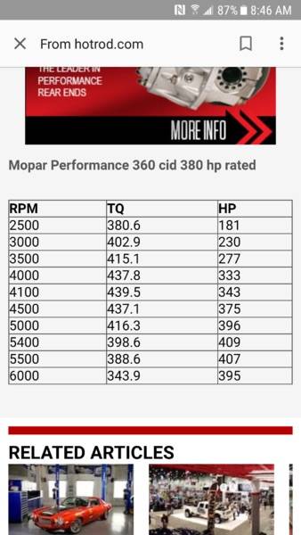

here’s the 380 hp crate engine makes 409 hp, guess knock of 20 or so hp since you got manifolds.
