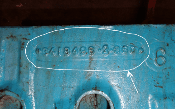

360 rear main
I'd check the block before ordering anything.

I know it’s a 360
