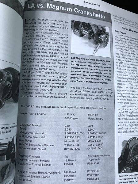

Thanks for all the help guys. I ended up finding this today. The differences are within la 318/340 and magnum plus some stroker crank variants
