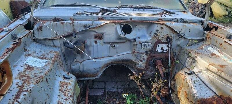

I have a 1976 Duster that came with a 225 6 cyl. Both the Engine and Wire Harness' are long gone. I am installing a 383 Big Block. Where can I get the wire harness and does anyone have any advice on this swap?
You should be able to buy motor mounts to swap the big block to the slant 6 K frame, from Schumaker engine mounts. @RAT ROD AL had a wiring harness from a Dart he parted out. It is a slant 6 harness, but you just need to splice wires to make it fit.
Will the 1975 Harness work with the 1976 Bulkhead? I've learned its different. It has Four Connectors, See attached photo.
Classic industries has engine harnesses for the swap. I got one for my 68 dart already setup for the electronic ignition conversion
