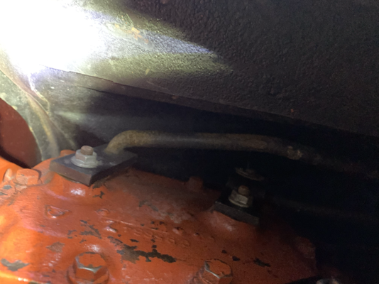

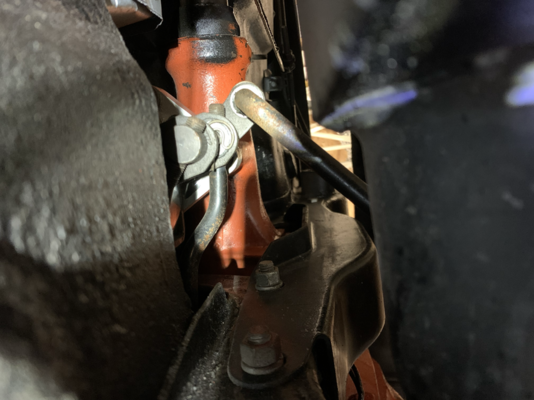

this is the best shot I could get until I get it on a lift or jacked up and put on stands. to my untrained eyes they look the same
Your pictures do not show the reverse rod on the trans. The linkage on the side cover are forward gears . The one coming out of the bottom of the case is reverse

I manipulated your photo to show you where the issue is. At the extreme lower right the reverse lever is just barely visible. I enlarged it in an inset for a little better detail as to the part everyone's mentioning.
