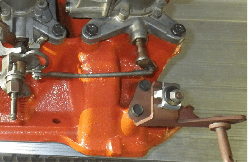

Here's where the '71 bracket locates...........

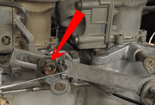

This bolt & nut needs to go. A spring pulls the kickdown forward. You'll need to get this set up correctly.........
Thanks, I’ll ditch it. I did find a bracket that’s in the mail, but I think it might be slightly different than that one.

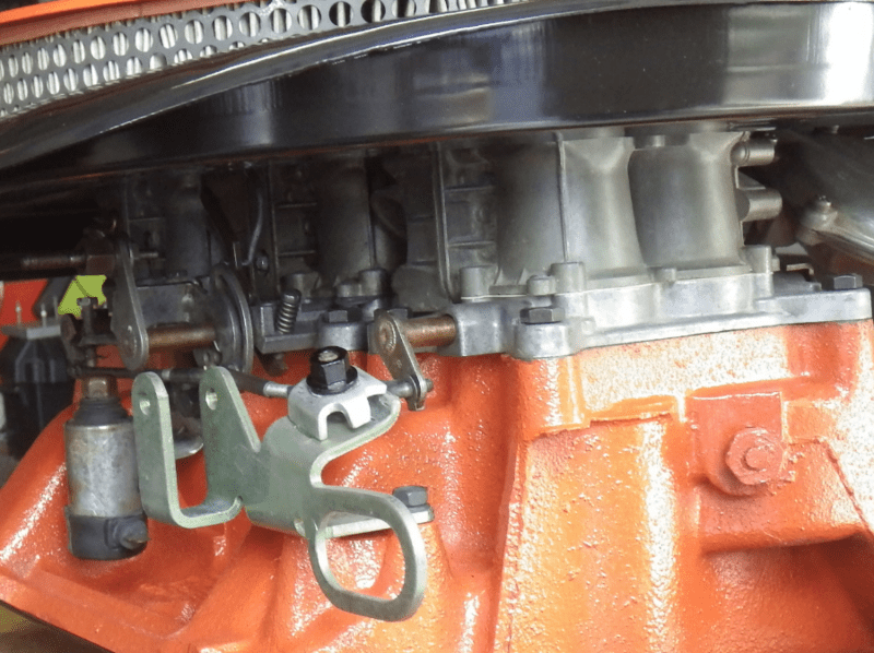

Same setup with a '69-'70 bracket. Uses different KD linkage............
That’s the bracket I ended up buying, haven’t received it yet. I don’t have time at the moment, but I’ll do some searching online to see if I can find the correct linkage.
