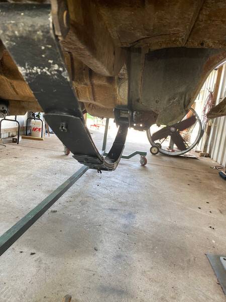

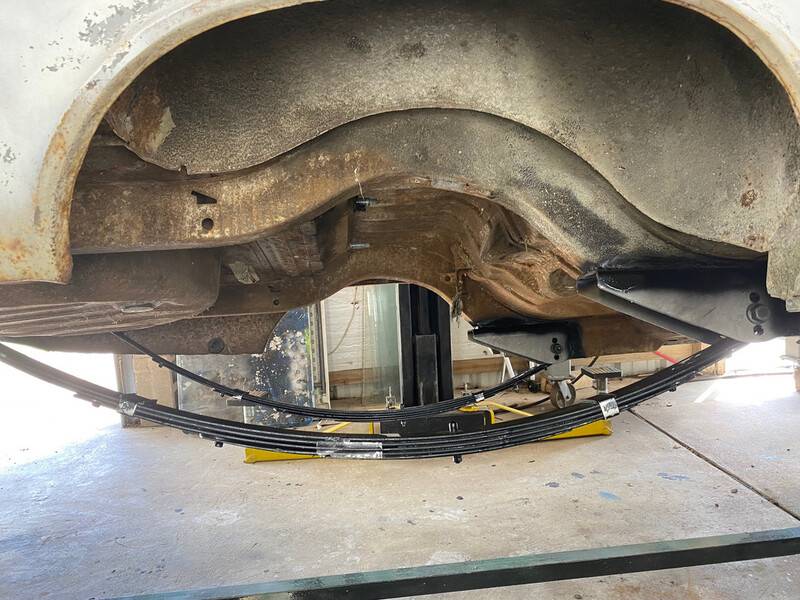

IN the meantime, I finished up welding in the spring relocation brackets~ new spring is just there and waiting for new rear shackles(be here soon), then go ahead and cut the old mounts off the axle(and careful measuring), then weld the new perches. Then that will be done.
I am a little worried about the arch of the new springs, I don't want a high rider in the rear.

Well you can always move the front of the leaf up to the top hole .
2.47 : 1 you won't need a tall tire , you'll be in overdrive without a O/D gear .

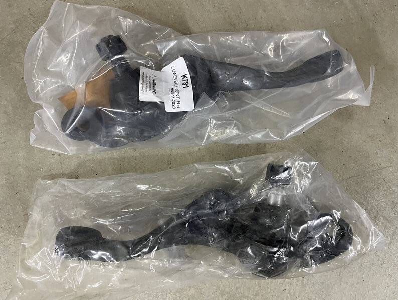

Oh here's a picture of the Lower ball joints if you want them .

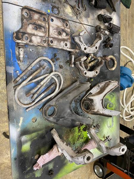

Went back out to the salvage yard where I bought the rear axle, just in time as they were fixing to totally scrap it! I got the upper control arms, spindles(disc), and the wheels it had. I'll be getting new tires, I'll be temporarily installing the axle to see how these wheels will fit. All for 350;)

I‘ll ship the lower ball joints to you this week. You did get the big bolts that connect the spindles to the lower ball joints right ?
Good morning Glen, I could hear you while the salvage man was disassembling the front, “don’t forget the big bolts” ;).

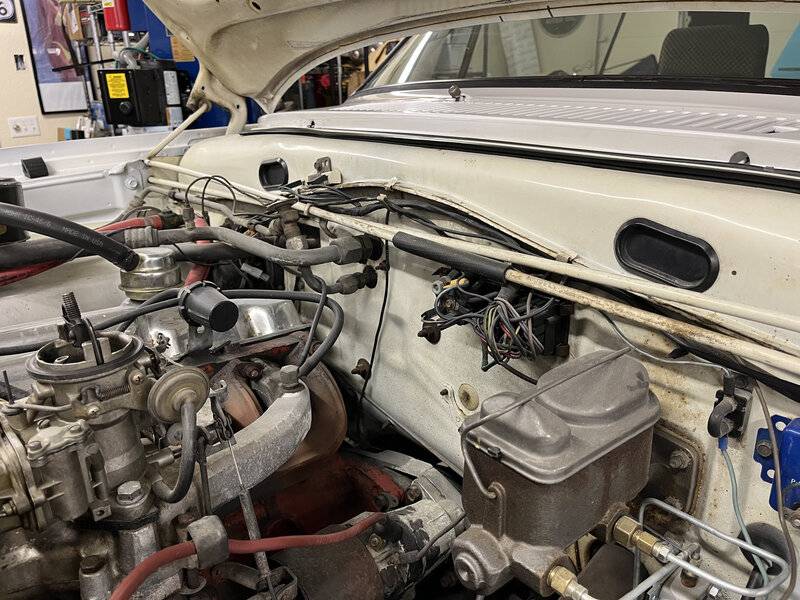

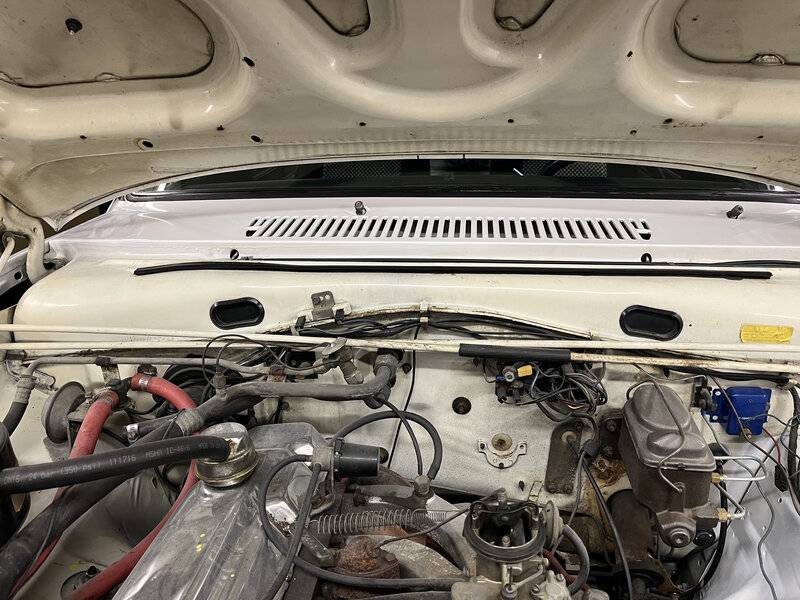

Dne' here's pics of my '66 firewall (note with Factory A/C) just ignore the A/C and the firewall is the same on '64-'66 .

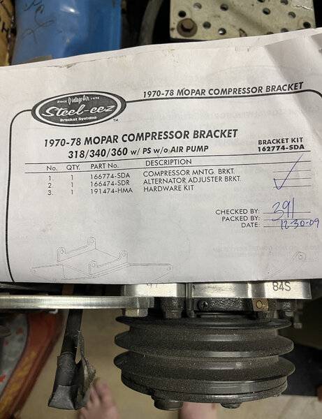

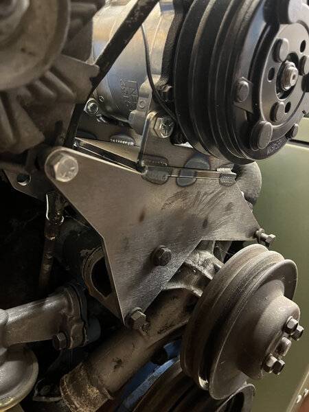

If you get the engine and trans from the late Valiant and they left all the accessory brackets you'll save a bunch of $$ . If not here's pics of the a/c , alt. bracket for the Sanden compressor . One important caviat when selecting an intake manifold it must place the thermostat in the factory location or it will be under the compressor , and that won't work . Edelbrock does make a manifold that will work .

Ok here's the rest of the pics . BTW note the dimple in the firewall it's for distributor clearance on the V-8 .
Oh and for comparison here's a '63 firewall .
