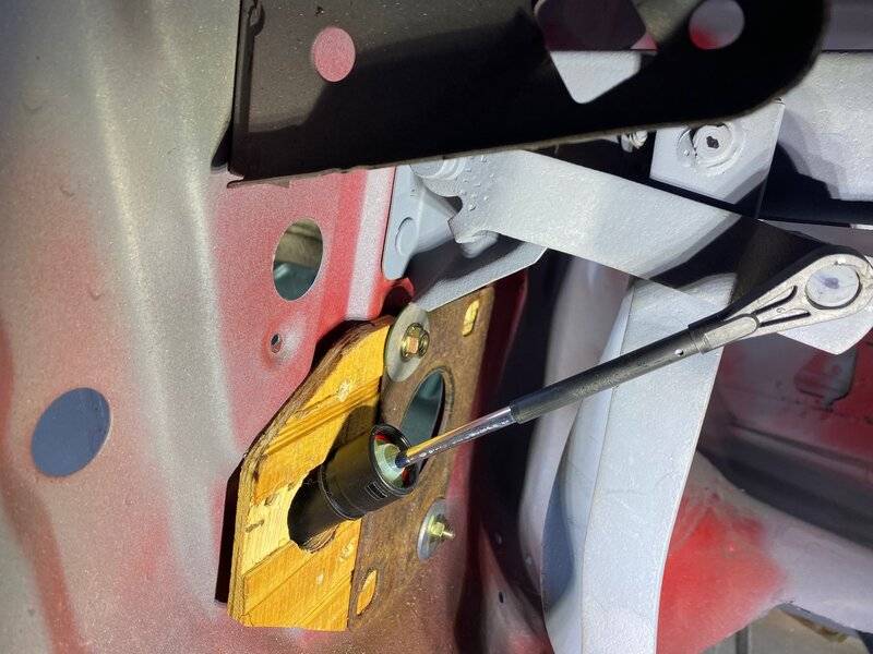

The wood piece represents the future strengthening plate, this one I have to redo, but gives the idea. The wood will go between the firewall, then the plate, then the steering column keeper. I'm hoping the
I was going to put the plate on the other side of the firewall, but changed my mind.

I was focusing on the depth of the clutch rod, yes I drilled extra holes too (doah), forgot to push the mc to the top of the hole, it needed that. The bolts will go through the strengtheng plate, it won't look like
this otherwise the firewall may flex without it.

Template time~ it's easy to do this with no dash, brake assembly out of the way, the pattern is a little higher where the CMC (clutch master cylinder) comes out due to the angle of the dangle
The white material is 3/16 aluminum sandwiched by the steering column retainer, still had mod the CMC hole in an oval fashion. Once I'm happy with the aluminum
piece, I'll buy some 1/4" plate, get Gary to buy me a new plasma cutter, then I'll make it myself. May not be a pretty as the one that do it professionally.
this is pretty much how it will look~ getting the angle of the CMC is a little challenging. just noticed I have the steering column plate upside down! grr
A couple things here, I need a shim with an angle to it, like 1/16 to 1/4", however cut up bondo spreaders work pretty good.
A far fetch thought was to take my porta power and push the firewall from the ledge where the back seat is and push it forwardly. But shims would be
safer I suppose. Fabricating this to be with reproducible results is quite challenging.

A few questions. :) Have you considered making your stiffening plate from steel that is the same thickness as the factory plate for the steering column support? If so, you should be able to get some thick tubular spacers from the hardware isle at Ace Hardware, cut them to the correct length to fit into the recessed area and put it between the top bolt on the outside of the firewall, between the CMC and the firewall. You have to nip the bottom corner off the tubular spacer to make it fit right, but it may work. Last question....does the CMC rod make a straight push from the clutch pedal, or does it even need to? It looks straight in one pic, but at a slight angle in the other is why I asked. Eat a Philly Cheese Steak sammich for me while you're there. I just had a killer one at my favorite place close by.
:thumbsup::thumbsup:
Hey JD, The aluminum plate in the pic was just for mocking up the "plate", it will be steel, but thickness? I really don't know how thick it should be. The firewall does contribute some considerable strength? So, maybe just 3/16? The tubular spacers~ Thank you for that idea :thankyou: ! That's been bugging me.
The clutch rod angle? I don't know what it is, is the firewall untrue? you see that it takes at least 1/4 in the right spot to bring the cmc into alignment. So depending on which picture you see, it could be off a tad, or just an illusion, or play on vision, and seems like most pictures I take, the pics come out a tad distorted. In the picture you can just make out what it takes to bring the cmc into good alignment. I have found sheet metal shims, kind of like the shims you get at Lowes for woodwork. I mentioned a far out idea of pushing strategically(guessing) with my porta power and push it out, but may wind up worse off. or maybe just a good whack with a block of work to lessen that gap. Whether it be shims, beating it, it will be "fixed";)
I had been thinking the idea of an external slave cylinder(not everyone would want to pull their transmission), just looks like nothing would work. I'll elaborate more on this a little later.
My setup is kind of working at this point, the most important thing now, install a throw out bearing, it will disengage the clutch like it's supposed to, may drag a bit, or not work at all. Even though Jeff is giving me 10% off, it's still almost 400 bucks and I don't get to return it like on Amazon.
Other: My 67 Mustang has the hydraulic setup, Mcleod slave, and releases about 1" from the floor~ never could get it any higher.
thank you for the questions :thankyou::thankyou::thankyou::thankyou:
I think I would use the same thickness steel as the steering column support, or only slightly thicker. I would shy away from welding the two plates together, so if you ever have to service one system or the other, you don't have to disassemble both to get either one out. You could make another one the same size as the mounting surface of the plastic CMC and mount it between the CMC and firewall to keep stress off the plastic on that side. That way it is supported on both sides. In the pic right above, the top bolt to the right that goes over the dip in the firewall is where I was talking about putting the tubular spacer. The other bolt shouldn't need one since it's on a flat surface. I'll shut up and quit creating work for you...lol. I was a power lineman my whole adult life and tried my best to over build every pole so I never had to go back and do rework. It kinda bled over into my car hobby! :BangHead: :realcrazy:

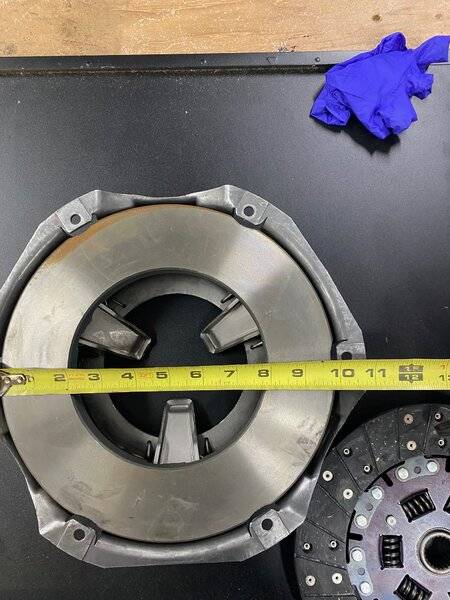

a 63-65 dart clutch on ebay. wrong disc, but correct pressure plate:
This is what I have from Rock Auto, it was a close out, total was 62 including shipping. LUK 05004. At that point I thought I was going to use the manual type. The friction plate is 9 1/4, so the disc is usable.
