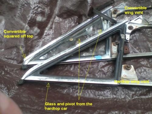

the lower pivot for the vent window on the 65-66 (don't have a 64 handy) are the same as the 2 door hardtop. I would assume the 64 is the same since a 64 hardtop and convertible door will fit on the 65(after changing the top pot metal piece). The difference is in the top pot metal wing vent assembly that goes towards the a- pillar convertible are squared off and the hardtops go to a bent point. same wing vent glass for both.
top wing vent differences
the wing vent glass fits in both the hardtop and the convertible. pivot too!
