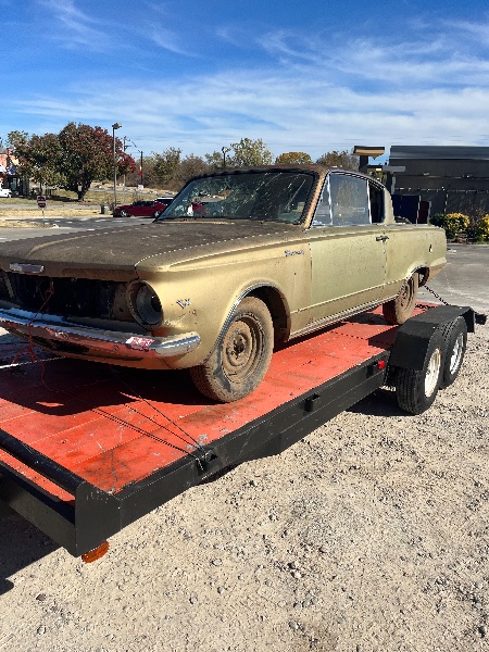

So I bought this gold 65 barracuda last year for $500 bucks just for the A/C system and the power steering. I might be interested in selling other parts off the car later. The car is not worth saving. The frame rails from torsion bar crossmember forward is Swiss cheese.

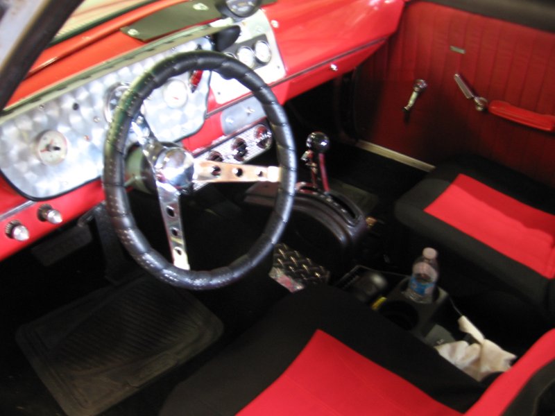

Not to deter you from factory A/C ,it may cost more than doing Vintage Air. I did Vintage for the Sanden compressor . It is also heat and a/c.
Sorry for the crappy photo. I have no idea what my under hood photo disappeared to. Just a thought.
