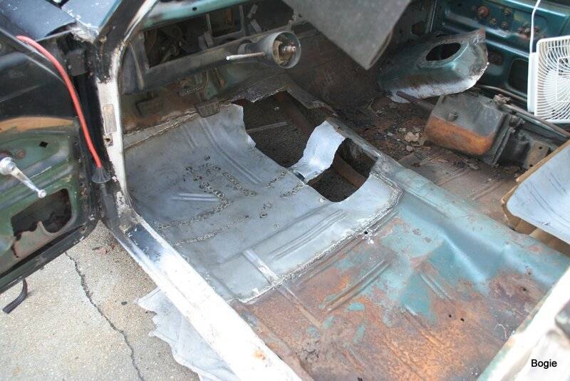

the hump layout is pretty self explanatory. it kinda just sits where it's supposed to.
you don't need to gack up the floor a massive amount, it's only the two cuts one ahead of and one behind the x-member.
i used panel bond and tech screws, so it's on there. it could come off if necessary, but i didn't see the need to take it any further than it is.
i'll see if i can find some pics of teh install/floor cut...
Factory holes in my 66 they don’t need to be that big

This is exactly what I did in my 73 Dart I did a conversion on... I did, however, cut inside of the scribed line so that I had some material to weld the new tunnel on. I hope this made sense.
Get the transmission in the car, along with the shifter mounting bracket. Once these are in, start with about a 3" hole based on the center line of the shifter. Once you have the initial hole, start trimming in small increments checking the shifter operation, as well as the placement for the shifter hump. Slow and steady makes for a neater and better installation.
Install the transmission and shifter then center the hole around the shifter in neutral, then it becomes self evident. I'd seal it with fiberglass and rivets.

You can open the door, stand back and throw the hump in the car and it might just land in the right spot. It's really THAT easy to locate.
