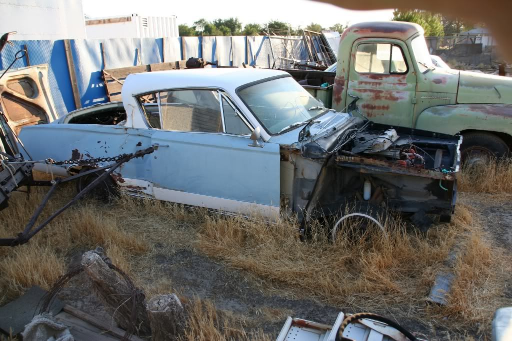

I have this out back if you need anything let me know and I'll ask about it. (technically it's my Uncles)
Here's to ya there 37 fleetwood. Lets see, 66 cuda+ rockers still on= trim clips. Ask your uncle and be careful taking those rockers off. If you need to force anything, make it the pushpin clips on the bottom. Pop them if you have to, but lift the rockers UP towards the door to get them off. That will spare the clips in need. Thanks for posting the offer to help, Geof
