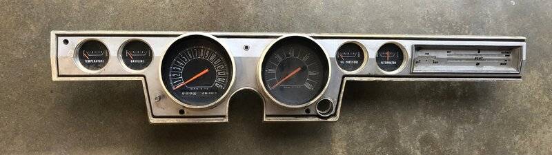

Is the black part that says Plymouth separate from the silver part? I snagged the pic of the Formula S gauges I bought, and I think the 2 other parts to finish it off are for the glove box door, and a smaller piece that goes between this gauge panel and the glove box door. I appreciate y'all contributing here to help edumacate me! :)

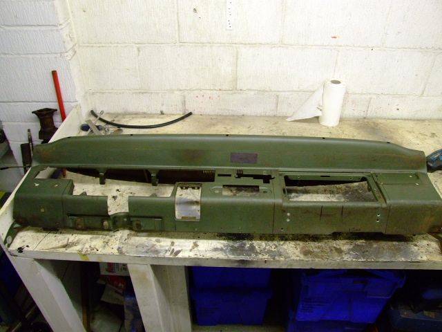

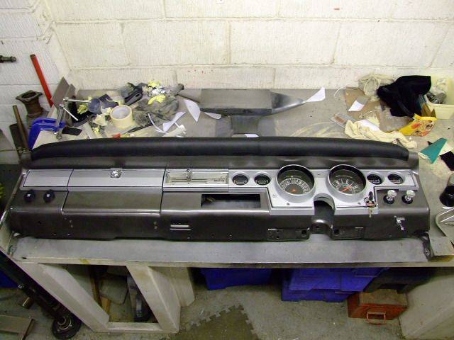

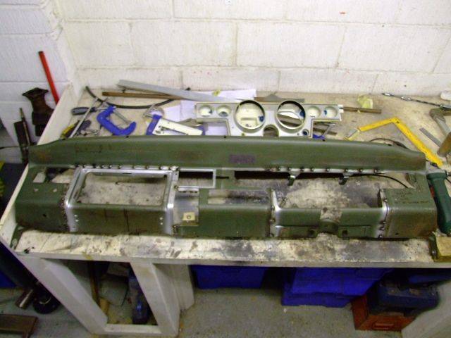

I put a 66 cuda dash in a 66 valiant. Some minor cutting to the valiant was needed as it is smaller and a different shape. Don't forget the glove box piece and the end cap piece to complete the job. Then I believe I had to modify the wiring plug into the
dash, I can't remember if the plug/pins where different its been 25 yrs.
but
yes i have converted it to RHD. plastics slightly modified but not too difficult.
