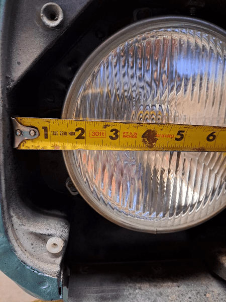

I'm reassembling my '66 Dart wagon after paint, I installed the grille and my newly acquired (used) headlight bezels when I ran into an issue on the driver's side fender- the bucket screws right in to the fender's factory holes, but the headlight is about a half inch off towards the side of the fender, and installing the bezel brought it to my attention when the headlight was waaay off center in the trim (I never had bezels on it before, they were a pain to find).
The headlight bucket looks identical to the passenger side one, and that side fits the bezel perfectly. It makes me think that over the years the car may have ended up with two right hand headlight buckets- I know the driver's fender was replaced at some point, and who knows what was used to mount the headlight...
So I guess that I'm looking for someone to confirm what I already suspect: that the two sides are, in fact, different. Then I can place an ad!
Oops, forgot the pic!

Yes, I was able to swap them side-to-side with the same results- the driver's side is "off".
And before anyone asks, neither fender is damaged or modified.
Sorry it took so long for pix, life got in the way...
Both buckets (trick of the camera- they're not as off-center as the pic makes them look):
Left (DS) headlight:
Right (PS) headlight:
And as I said, I can switch them side-to-side, and the driver's side remains "off".
Actually, since these pictures were taken, I've slotted/massaged the mounts, and shimmed the contact area between the seat and shell and got it to line up a bit better, but it's not quite there yet...
