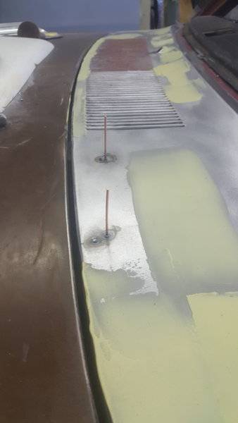

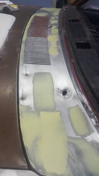

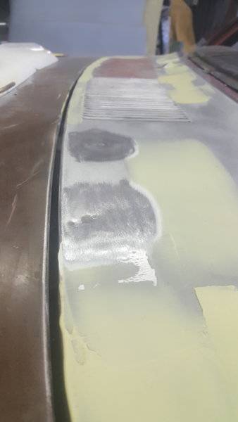

Went out there for about an hour or so tonight. Plastic peeled off like a charm. Just like i thought it might. I sanded the JB weld down, applied some fine polyester scratch filler over the top of the JB weld, and on all the clean pitted steel areas (yellow filler). Those areas will get sanded smooth all the way down to bare metal with 220 and the filler will only stay in the pits to hide the pitting.
I also used my stud puller and pulled the 2 dents on the left side of the cowl out a bit, filled them and the screwdriver pry marks around the LH wiper shaft hole with regular dent filling body filler (pink). Once those get sanded to shape, i will apply the yellow scratch filler over them, and sand them smoother with 220 sandpaper.
Went out there for about an hour or so tonight. Plastic peeled off like a charm. Just like i thought it might. I sanded the JB weld down, applied some polyester scratch filler over the top of the JB weld, and on all the clean pitted steel areas. I also used my stud puller and pulled the 2 dents on the left side of the cowl out a bit, filled them and the screwdriver pry marks around the LH wiper shaft hole.
