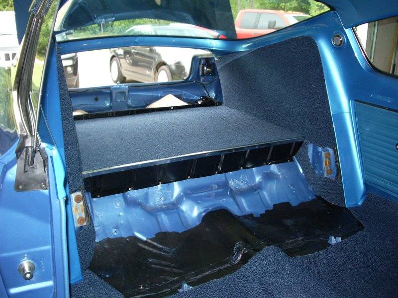

I can't reach my lower seat rear bolts with the folding back installed without a lot of contortion a wrench and cussing. I installed the lower seat then the folding back fully assembled. 4 bolts hold the back through the hinges. My car had two shim packs that go between seat back hinge and the body for alignment as well. The shims were originally taped to the body mount and I did it the same way after restoration and re-assembly. Covers on the hinges were installed lastly.
You can see the shims here.

Yes I do have the shims in all the stuff I got with the car.I noticed that for some reason the previous owner cut the front hook mount off the floor. So I guess that is some thing I'll have to add. I also notice your carpet runs all the way back on the sides?

That sux, hope you get better. Yeah the carpet goes all the way back and under the c-piller covers.
Well when I looked at your picture I also noticed the carpet extends on the sides all the way back on the sides. The PO cut the new carpet off straight across where the hooks should be. I have plenty of new carpet, guess I'll be seaming some carpet.
