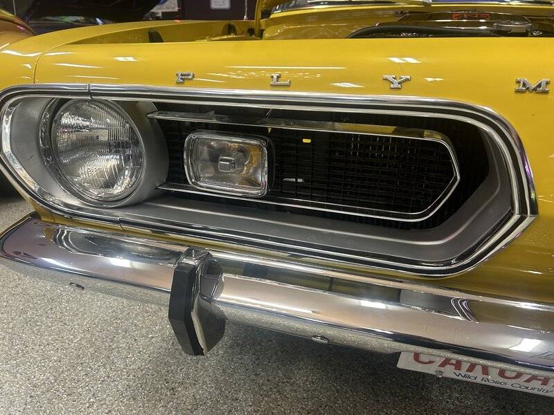

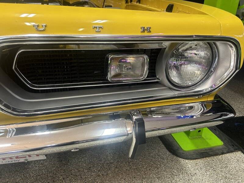

Tedious but making progress. Found fix for a couple buggered up studs. I cheated twice on this. I had painted the black stripe and it needed improving. I ended up running trim tape over top and helped "even" out the look. Cheat #2 was using blind rivets in a couple spots. The cloaest size had a tan color painted on them. Gotta scuff that off on 2 of them. In all i used 6 rivets. 2 are totally hidden and the other 4 are in in the upper half. You have to kneel down and look up to notice.
Next is inner honey comb and surround.
I've had to dunk it several times I think lye solution is weakening.
Inner on pass side done. To be honest I'm dreading doing drivers side lol. I'm not even half way done lol. Inners sanded by hand to 2000, then polished with drill and rouge. Starting with black and ending with blue? A card I have states it's the finest? Dunno. It's way better than it was, not totally happy with leading edge as more sanding should have been done, BUT the leading edge isn't rounded, it's angular like a shitty valve job lol.
I then worked on cleaning honeycomb. Tedious and we will see how durable it is as it is near 1st line of defense.
Spray primed, then Beautitone satin black, then Beautitone Semigloss Clearcoat.
Letting cure, then lightly scuffing leading edge of honeycomb. Well see if I like or not.
Oh I also used Blue Magic metal polish. It has a "protectant" of some sort.
Hope to assemble/reinstall soon lol.
Pass side all done. A couple blemishes, but still looks better than drive side with anodizing.
