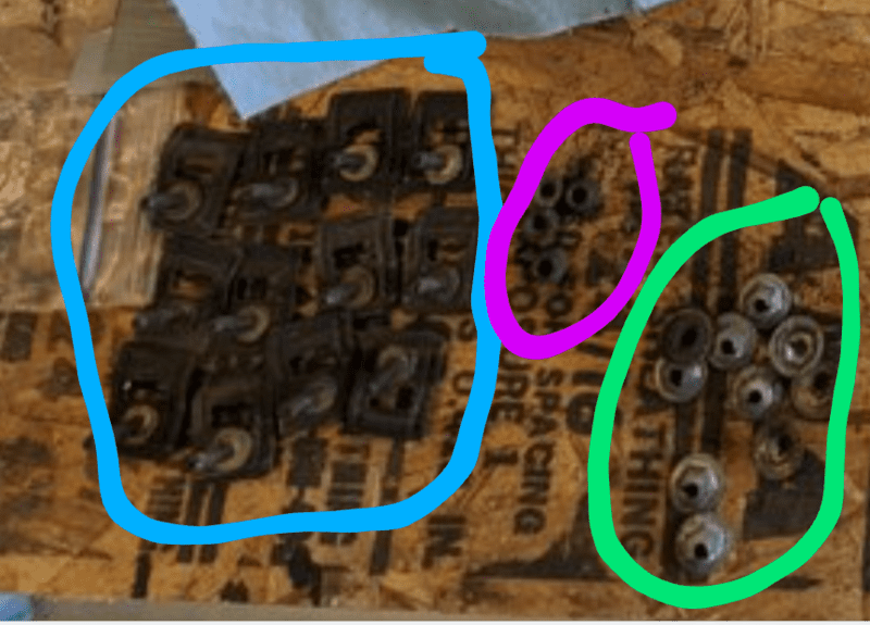

I am having a heck of a time trying to get the outside edge clips in. Not sure what order they go in, Carl has been apart for over 10 years. Not sure what IIRC is?
Post photos of the clips and one piece of trim I'll see if I remember.
Here is a picture of one piece of trim and the clips that I have. I guess one big question is how do I get the clip onto the bent end without destroying trim.
Post a photo of the back of the trunk lid
I don't recall there being odd shaped clips BUT the 4 outer holes might take an offset clip.
The 4 acorn nuts go on the studs that are in the outer 4 corners.
All of the clips go in through the cutout
Main clips - blue
Acorn nuts - pink
Main clip nuts - green
(put some dumdum on the face of all nuts)
Outer 4 corners? - red?
Unknown? - yellow?
1/2 trunk lid.
Main clips - red
End clips - green
You have 12 main clips and 4 end clips.
The count is good.
I'm up to 98.5% certainty on what I have noted.
I really can't place the 4 on the far right of your photo.
Main clips - blue
Acorn nuts - pink
(put some dumdum on the face of all nuts)View attachment 1715987764
Unknown? - yellow?
1/2 trunk lid.
Main clips - red
End clips - green
The count is good.
The dress up full panel screws on to the trunk with small screws, before the 4 trim pieces.
The many small holes in the center of the trunk lid get water resistant tape over them, they are there for lettering if not a GT.
Wish I had taken photos!!!! Aaarrrrgghg!

I think you are there. The clips can only go on one way, and the trim can only go on one way.

Just to confirm the clips on the far right in your photos (yellow cir) were not used, correct?
I'll be Intrested to find where those other clips go or not
