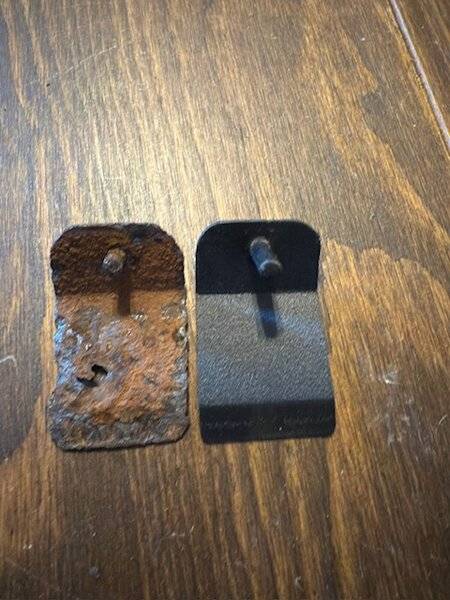

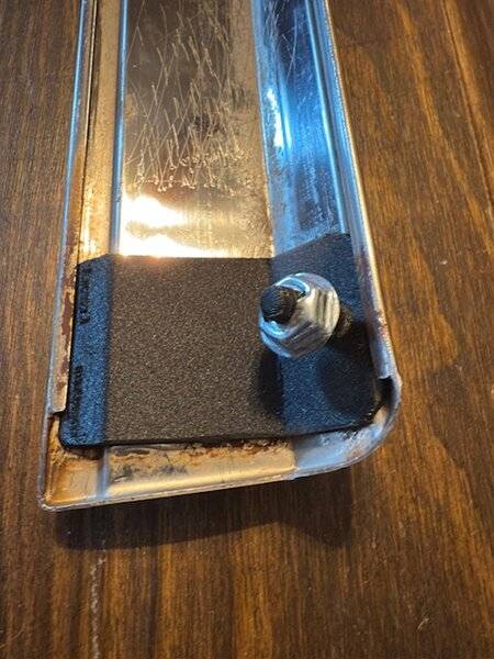

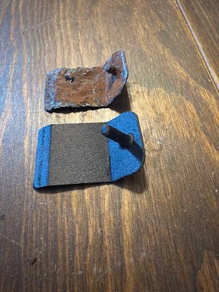

I couldn't find anywhere that was remaking the clips that hold the trunk trim piece on. So I tried to recreate one and 3d print it. Printed it out of PPA-CF which is a carbon fiber reinforce Nylon. Seems strong enough for the forces involved here. Uses 3/8" speed nuts to cut the threads. The fit is pretty snug on purpose.
If anyones interested in these, I could send some out or share the STL and you could print some yourself. PLA seemed strong enough but I was worried about heat warpage. PETG and ASA both didn't have the strength that would have made me feel comfortable using them.
