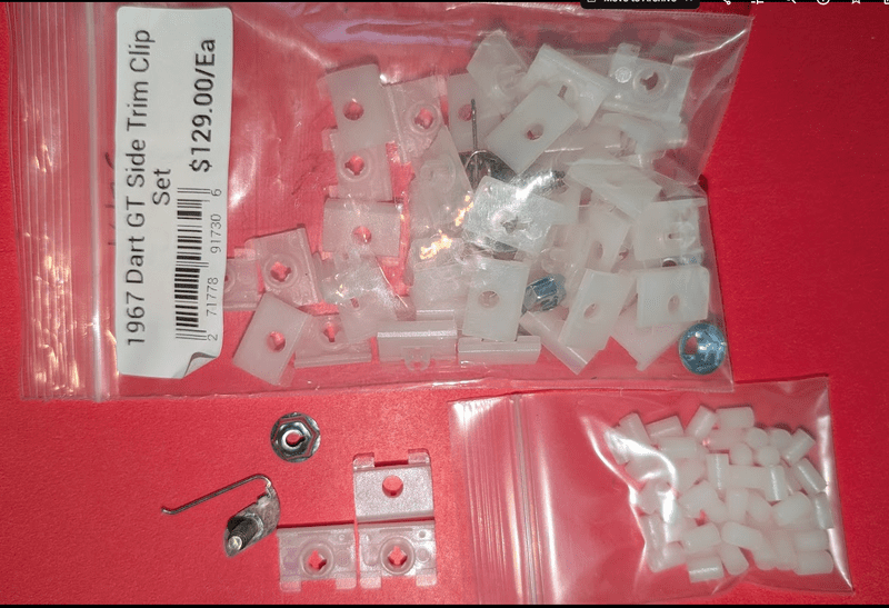

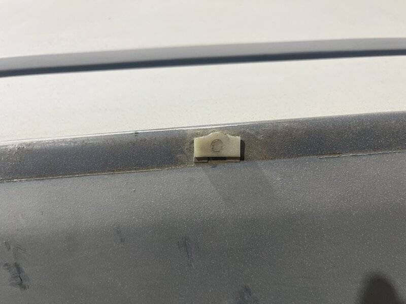

The owner was worried to remove clips and trim before paint but I want them removed. The main clips I’m concerned with are the plastic ones along the tops of the fenders that run all the way along the car. I found a kit from RT specialties and wanted to get anyone’s opinion on it before I buy it. Here is a link to that set of clips : 1000147S SIDE TRIM CLIP SET 67 DART GT, BODY, 1000147S :Mopar Fasteners, Clips & Hardware

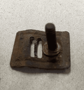

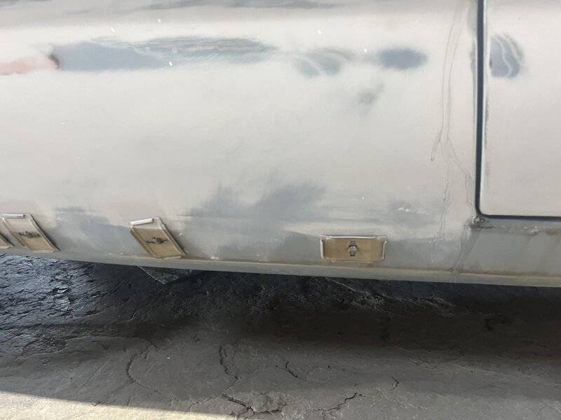

Also any techniques for reusing the metal rocker clips that go along the bottom is greatly appreciated.

I have 2 sets of the RT specialties clips BUT i have not used them yet. They look good though.

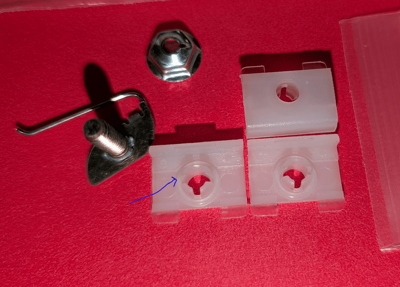

I'm sure you already figured out that the fender, door and quarter top trim has nuts on some of the ends. and when removing the plastic clips try to pull the centers out ( drill a small hole in the center pin and put a screw in it OR the pin will be inside your door, quarter panel etc and could rattle.
blue points to o ring

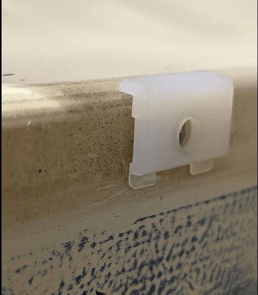

rocker clips have a center part the gets spread apart GENTLY to release them from the body. They get squeezed to reattach them. I would put some Body sealer in, on and around the hole when reattaching them.

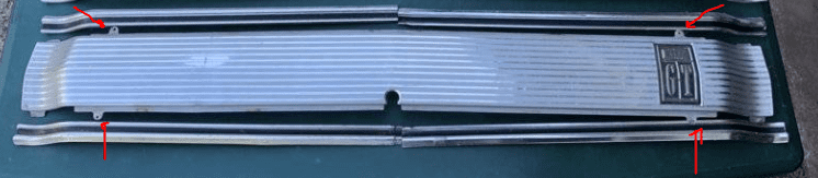

As for trunk trim, yes there are clips on the 4 pieces that hold the trunk full badge on plus the 4 screws that are pointed to in red.

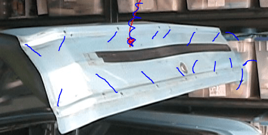

I'm looking for a photo of the trunk trim clips I do not think they are reproduced.
Where the clips go (blue ignore red and blue squiggle)
this is what all but the 4 outer clips look like

no, the clips where the blue lines point are specific to the trunk trim that surrounds the full cover. I don't think they are preproduced.
67 Dart GT trunk trim post 7 shows all the trunk clips and where they go. Not sure what you mean about the other 4

there are no clips holding the full badge on, just the 4 screws
There are clips holding the 4 pieces of trim that surround the full badge on the trunk.
