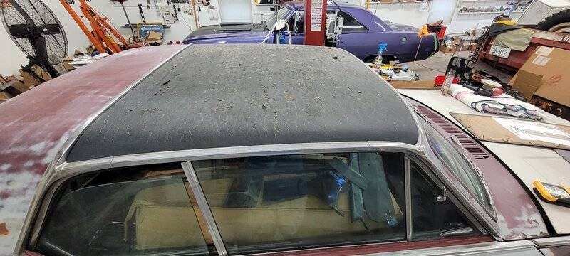

Had an internal clip that holds the roof trim in place that wore out and broke.
I was wondering if there are any other attachment methods or a way to buy the clips individually
Any ideas would be great
I am trying to figure out a way to fasten it to the roof without removing the headliner
Thank you!

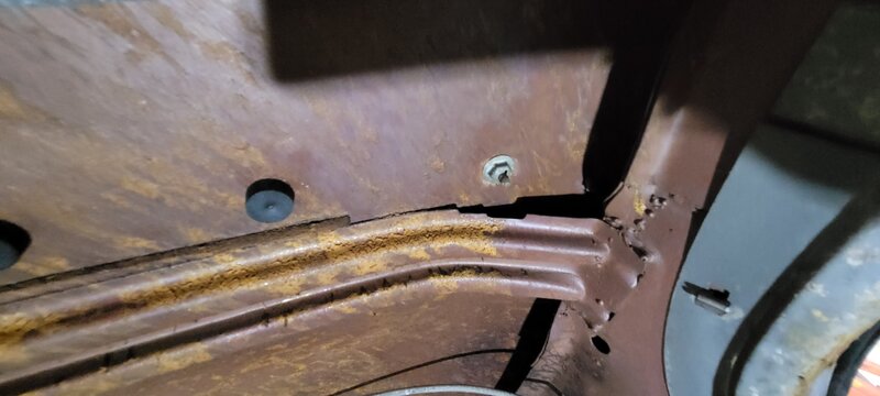

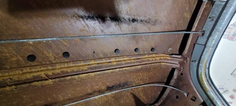

Here's what my 65 GT roof looks like inside . There are 13 rubber grommets that hold a screw that goes through the roof and holds each clip. There is also a tinnerman nut on each end that holds another screw/bolt. My trim is still attached so I don't know how easy it is to release the trim from the clips. So, I agree with @toolmanmike, @mopowers and @Professor Fate it should be possible to rivet or screw the clips back on. The grommets and tinnermans would then just fall into the headliner. I'm thinking the rubber grommets are there just to keep the screws from poking through the headliner if someone pushes up on it.
The clips do attach to the roof panel but the big issue I have is the clips being worn out and broken. Like GGs66GT said removing the headliner is way more involved and I would like have to take it to be done to avoid risking damaging the glass which I know will be a fortune to replace. I was hoping there were replacement clips or another way we could brainstorm to fasten the trim to the roof/sheet metal screws that held the original clips in place
