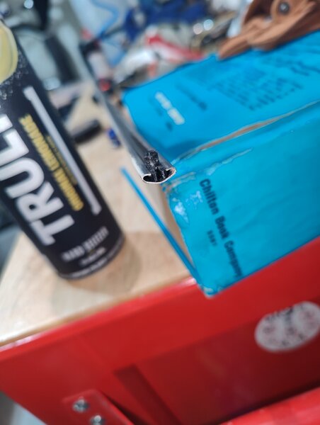

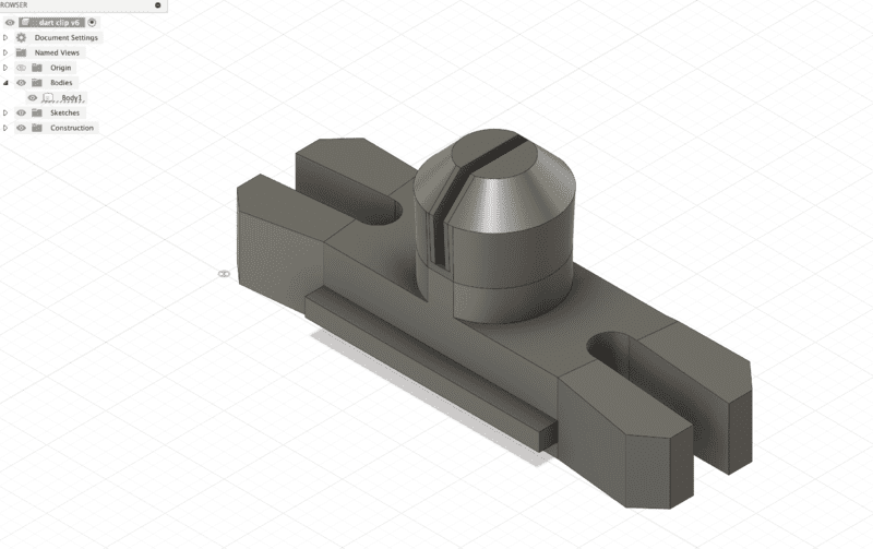

Hello - In case anyone else could possibly use it, I've designed and 3D printed my own trim clips for the "C" channel chrome trim that runs the length of the body. My old clips were dry, broken, and crappy.
These new ones are extremely sturdy (even reusable) and slide right into the rails with little to no fuss. I spent about 15 hours getting them perfect so I could reattach all my trim with security.
Files are found here if you're interested. Send me a message if you'd like me to print and mail you some clips. Thanks!

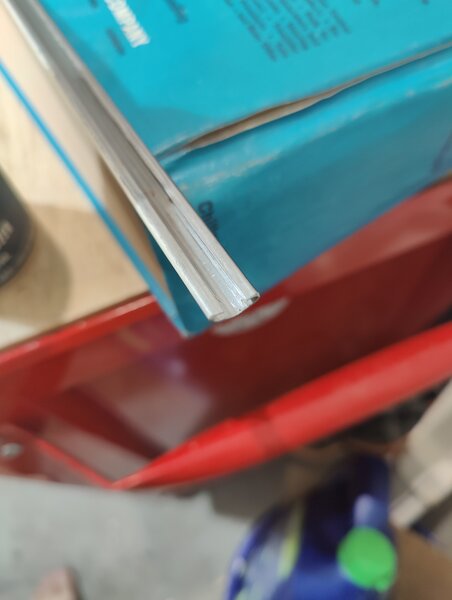

For anyone looking for more details, there are 124 clips needed for the thin, waist high trim surrounding the car. As of yet I don't know how the little triangles on the send attach, but it may be similar. The trim pieces use clips as shown below. 8+9+14 * 4 = 124.
