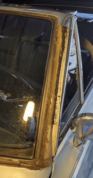

Clean A pillars, old windshield seal

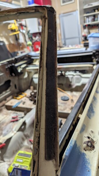

Foam Seal install (new windshield gasket)

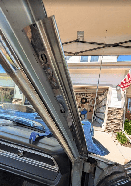

Hidden Screw A Pillar Door Seal

The red arrow is the A Pillar door seal hidden screw hole in the outer upper trim
The blue arrows are for the A Pillar door seal channel

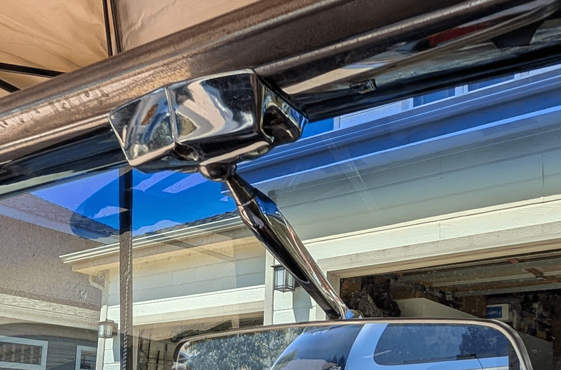

Review mirror mounted
You can see the remains of the seal (red arrow) before cleaning
After cleaning
