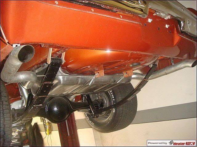

This is a general idea of what any good exhaust guy can do with your tailpipes. We have an A body guy that owns an exhaust shop locally who can do whatever you want. I have dumps on mine, always did, so I never worried about tail pipes.
Beware of this method if you run large exhaust and the car doesn't sit up high.
But there are definitely ways to route to the bumper and that IMO should be the preferred routing of the exhaust.
